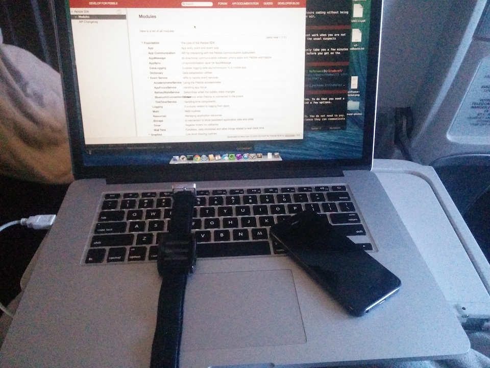

I love working on the plane. It is one of those rare place where I can spend 8 hours coding without being disturbed by emails, phone, etc. Here are a few tips to write Pebble apps in the air.

2. Use the documentation packaged in the SDK
You may not know this but your local SDK install contains a full copy of the API Reference. You can open it directly from the filesystem in your browser: file:///Users/thomas/pebble-dev//Documentation/pebble-api-reference/modules.html.
Another great way to read the documentation is to use Dash and the Pebble doc bundle provided by Roger Braunstein.
You also get a full copy of the examples in /Examples.
