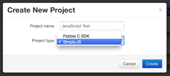

CloudPebble recently gained support for building Simply.js projects – which means you can now write, build and install simple apps entirely in JavaScript and inside your web browser.
To get started, head to CloudPebble and create a Simply.js project:
Create Simply.js project
