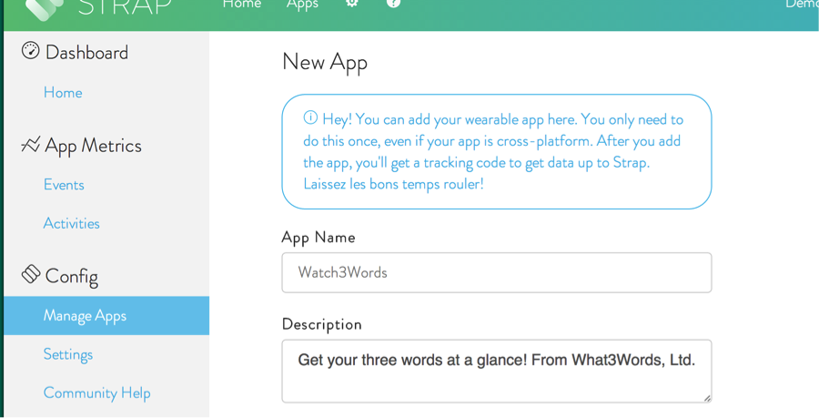

1) Create an app on the Strap dashboard.
1

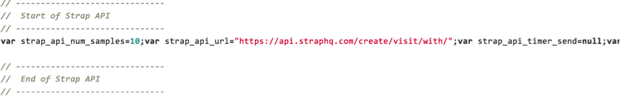

5) Add the JS API to your JavaScript code
In the SDK you'll find a sample pebble-js-app.js which contains the API. Copy the API portion of the code to the top of your js file.
3
