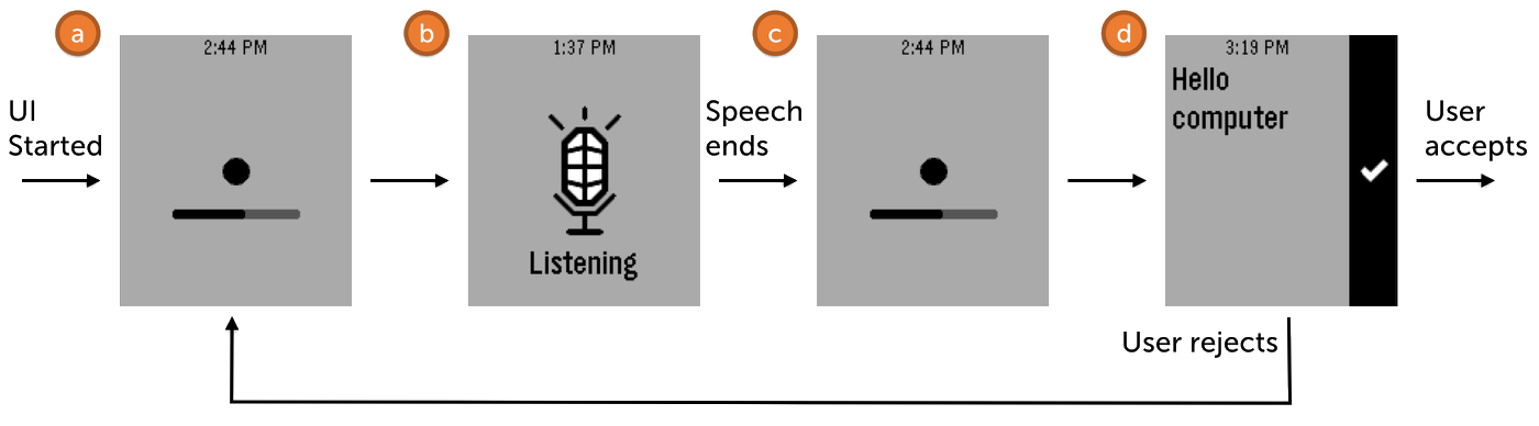

The Pebble Dictation Process
The Dictation API has been made incredibly easy for developers to integrate into their watchapps. It’s also intuitive and simple for users to interact with. Here’s an overview of the the dictation process:
  1. The user begins by pressing a designated button or by triggering an event within the watchapp to indicate they want to start dictating. The watchapp’s UI should make this obvious.
  2. The watchapp initiates a dictation session, assigning a callback function to handle the response from the system. This response will be either successful and return the dictated string, or fail with an error code.
  3. The system Dictation UI appears and guides the user through recording their voice. The stages in the image below illustrate:
    a. The system prepares its buffers and checks connectivity with the cloud service.
    b. The system begins listening for speech and automatically stops listening when the user finishes talking.
    c. The audio is compressed and sent to the cloud service via the mobile application.
    d. The audio is transcribed by the cloud service and the transcribed text is returned and displayed for the user to accept or reject (this behaviour can be programmatically overridden).
  4. Once the process has completed, the registered callback method is fired and the watchapp can deal with the response.

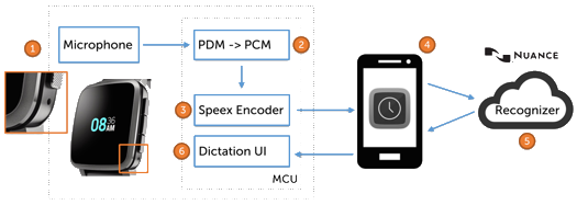

But How Does It Actually Work?
Let’s take a closer look at what’s happening behind the scenes to see what’s really going on.
dictation-recognizer
  1. To capture audio, Pebble Time (including Time Steel and Time Round) has a single MEMS microphone. This device produces output at 1 MHz in a PDM format.
  2. This 1 bit PDM signal needs to be converted into 16-bit PCM data at 16 kHz before it can be compressed.
  3. Compression is performed using the Speex encoder, which was specifically designed for speech compression. Compression needs to occur in order to reduce the overall size of the data before it’s transferred via bluetooth to the mobile application. Speex also has some additional advantages like tuneable quality/compression and recovery from dropped frames.
  4. The mobile application sends the compressed data to Nuance Recognizer, along with some additional information like the user’s selected language.
  5. Nuance performs its magic and returns the textual representation of the spoken phrase to the mobile application, which is then automatically passed back to the watchapp.
  6. The Dictation UI presents the transcribed text back to the user where they can choose to accept or reject it.
