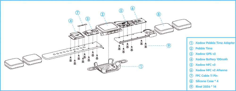

rephone-smartstrap-kit-diagram
RePhone Strap Kit diagram courtesy of Seeed Studio
Assembling the components was a reasonably straightforward process, although my chunky fingers and poor eyesight didn’t always make it quite as easy as it should have been. First you need to fix the adaptor to the back of your Pebble, then attach the watchstrap, making sure to feed the ribbon cables that extend from the adaptor through on top of the watch strap. Each module needs to be interconnected as per the instructions above.

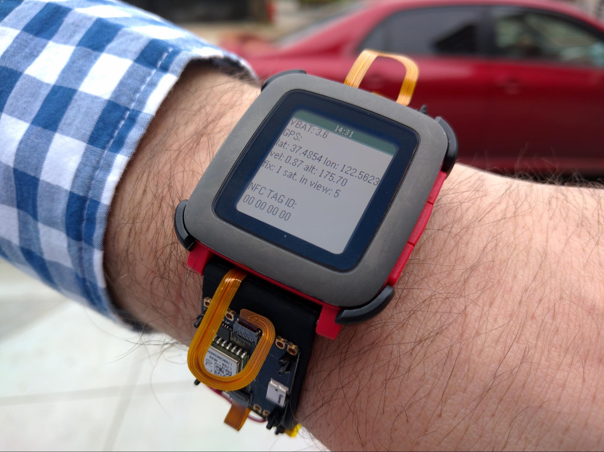

After getting everything hooked up and the watchapp installed, I was disappointed when the GPS didn’t initially appear to be working. I headed outside with my watch and stood in the street for a while, and pretty soon the number of visible satellites started to increase and then the GPS position was established.
It honestly felt like wearing some kind of futuristic time travel device with all of the wires and circuits exposed. I wouldn’t recommend walking into an airport like this, but I actually quite enjoyed the aesthetics.
The next thing to test was the NFC module, and thankfully this was really simple. I held my NFC enabled phone against the NFC antenna and sure enough, the tag ID appeared. I also used it to successfully scan another NFC chip, but this one was embedded directly inside someone's hand. Apparently there’s some seriously dedicated next-level biohackers at Pebble!
The battery module supplied with the kit is used to power the GPS and NFC modules, but you can also use it to charge the Pebble itself. I didn’t have time to perform any testing other than confirm that the Pebble was infact charging from the strap’s battery. The battery module is 100mAh, compared to the 150mAh battery in the Pebble Time, pretty impressive for something so small!
