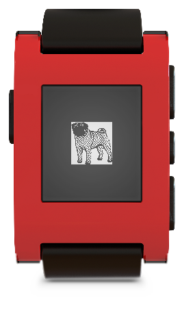

BitmapLayer
Layer that displays a bitmap image.
BitmapLayer is a Layer subtype that draws a GBitmap within its frame. It uses an alignment property to specify how to position the bitmap image within its frame. Optionally, when the background color is not GColorClear, it draws a solid background color behind the bitmap image, filling areas of the frame that are not covered by the bitmap image. Lastly, using the compositing mode property of the BitmapLayer, determines the way the bitmap image is drawn on top of what is underneath it (either the background color, or the layers beneath it).
Inside the Implementation
The implementation of BitmapLayer is fairly straightforward and relies heavily on the functionality as exposed by the core drawing functions (see Drawing Primitives). BitmapLayer's drawing callback uses graphics_draw_bitmap_in_rect() to perform the actual drawing of the GBitmap. It uses grect_align() to perform the layout of the image and it uses graphics_fill_rect() to draw the background plane.
