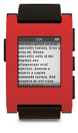

ScrollLayer
Layer that scrolls its contents, animated.
Key Points
  • Facilitates vertical scrolling of a layer sub-hierarchy zero or more arbitrary layers. The example image shows a scroll layer containing one large TextLayer.
  • Shadows to indicate that there is more content are automatically drawn on top of the content. When the end of the scroll layer is reached, the shadow will automatically be retracted.
  • Scrolling from one offset to another is animated implicitly by default.
  • The scroll layer contains a "content" sub-layer, which is the layer that is actually moved up an down. Any layer that is a child of this "content" sub-layer, will be moved as well. Effectively, an entire layout of layers can be scrolled this way. Use the convenience function scroll_layer_add_child() to add child layers to the "content" sub-layer.
  • The scroll layer needs to be informed of the total size of the contents, in order to calculate from and to what point it should be able to scroll. Use scroll_layer_set_content_size() to set the size of the contents.
  • The button behavior is set up, using the convenience function scroll_layer_set_click_config_onto_window(). This will associate the UP and DOWN buttons with scrolling up and down.
  • The SELECT button can be configured by installing a click configuration provider using scroll_layer_set_callbacks().
  • To scroll programatically to a certain offset, use scroll_layer_set_content_offset().
  • It is possible to get called back for each scrolling increment, by installing the .content_offset_changed_handler callback using scroll_layer_set_callbacks().
  • Only vertical scrolling is supported at the moment.
