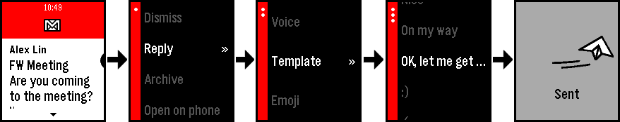

Allow Extended Options with an Action Menu
actionmenu
If an app screen demands a larger range of available actions than the ActionBarLayer will allow, present these as a list that slides into view with a press of the Select button using an action menu. This menu contains all the available options, and can contain multiple sub-menus, providing levels. The user can keep track of which level they are currently looking at using the breadcrumb dots on the left-hand side of the screen when the action menu is displayed.
Once an action has been chosen, the user should be informed of the success or failure of their choice using a new alert dialog window. In the system action menus, these screens use an eye-catching animation and bold label to convey the result of the action. This feedback is important to prevent the user from getting frustrated if they perceive their input has no result, as well as to reassure them that their action has succeeded without a problem.

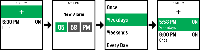

Get User Input with a Form
list
Apps such as the system Alarm app make use of a list of configurable items, with each active alarm treated as a menu item with properties. The status of each item is displayed in a menu, with the Select button initiating configuration of that item.
When an item is being configured, the data requried to create the item should be obtained from the user through the use of a form, with manipulable elements. In the Alarms example, each integer required to schedule an alarm is obtained with a number field that can have its value incrememted or decremented using the intuitive Up and Down buttons. The current form element is highlighted with color, and advancing to the next element is done with the Select button, doubling as a 'Confirm' action when the end of the form is reached.
