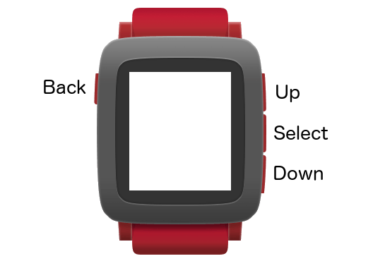

Button Clicks are the primary input method on Pebble. All Pebble watches come with the same buttons available, shown in the diagram below for Pebble Time:
button-layout
These buttons are used in a logical fashion throughout the system:
  • Back - Navigates back one Window until the watchface is reached.
  • Up - Navigates to the previous item in a list, or opens the past timeline when pressed from the watchface.
  • Select - Opens the app launcher from the watchface, accepts a selected option or list item, or launches the next Window.
  • Down - Navigates to the next item in a list, or opens the future timeline when pressed from the watchface.
