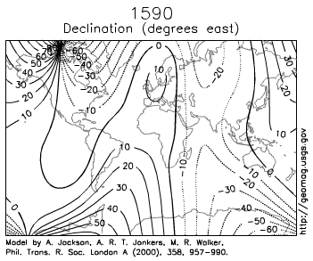

Magnetic North and True North
Depending on the user's location on Earth, the measured heading towards magnetic north and true north can significantly differ. This is due to magnetic variation, also known as 'declination'.
Pebble does not automatically correct the magnetic heading to return a true heading, but the API is designed so that this feature can be added in the future and the app will be able to automatically take advantage of it.
For a more precise heading, use the magnetic_heading field of CompassHeadingData and use a webservice to retrieve the declination at the user's current location. Otherwise, use the true_heading field. This field will contain the magnetic_heading if declination is not available, or the true heading if declination is available. The field is_declination_valid will be true when declination is available. Use this information to tell the user whether the app is showing magnetic north or true north.
Declination illustrated
To see the true extent of declination, see how declination has changed over time.
