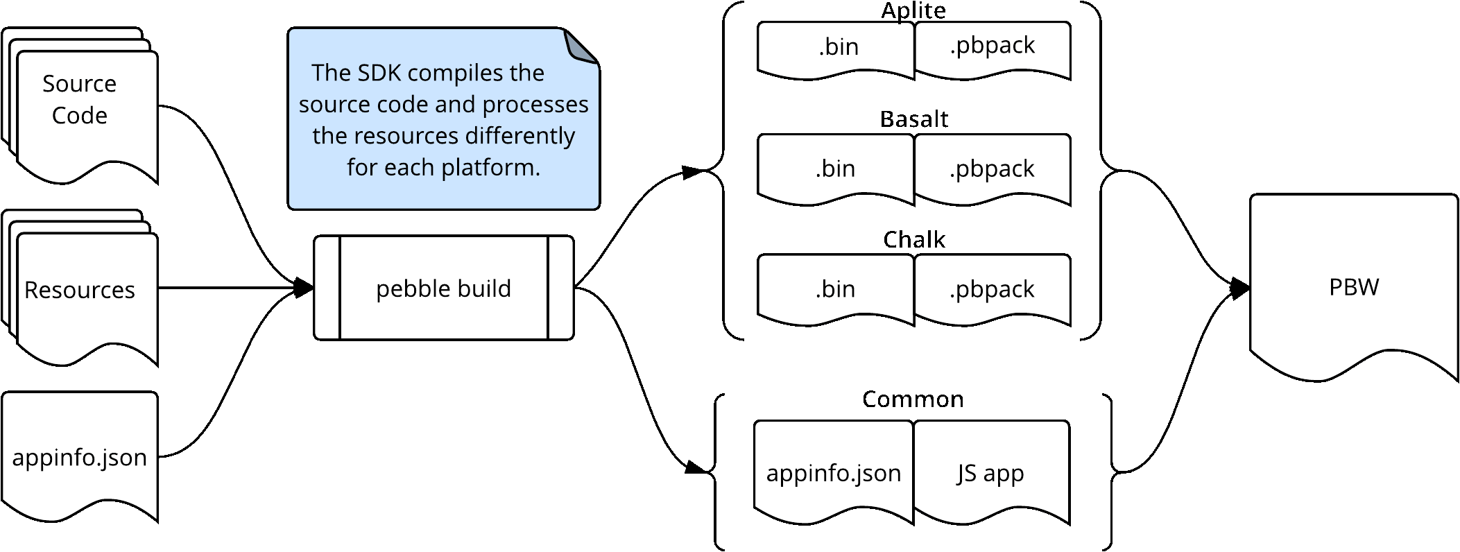

Apps will specify which hardware platforms they support (and wish to be built for) by declaring them in the targetPlatforms field of the project's appinfo.json file.
"targetPlatforms": [
  "aplite",
  "basalt",
  "chalk"
For each platform listed here, the SDK will generate an appropriate binary and resource pack that will be included in the .pbw file. This means that the app is actually compiled and resources are optimized once for each platform. The image below summarizes this build process:
build process
Note: If targetPlatforms is not specified in appinfo.json the app will be compiled for all platforms.
