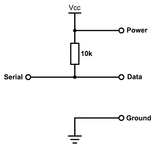

Single-component Data Interface
The simplest interface to the smartstrap connector is just a pull-up resistor between the power and the data pin of the watch. This pull-up is required so that the watch can detect that something is connected. By default the data bus will be at +3.3V and the watch or the smartstrap can force the bus to 0V when sending data.
This is the general principle of an open-drain or open-collector bus. Refer to an electronic reference for more information.

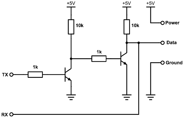

Transistor-based Buffers
When connecting the smartstrap to a micro-controller where the above options are not possible then a little bit of hardware can be used to separate the TX and RX signals and emulate a standard serial connection.

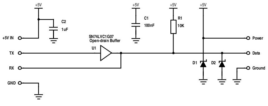

A More Professional Interface
Finally, for production ready smartstraps it is recommended to use a more robust setup that will provide voltage level conversion as well as protect the smartstraps port from over-voltage.
The diagram below shows a suggested circuit for interfacing the smartstrap connector (right) to a traditional two-wire serial connection (left) using a SN74LVC1G07 voltage level converter as an interface with Zener diodes for ESD protection.
strap-adapter

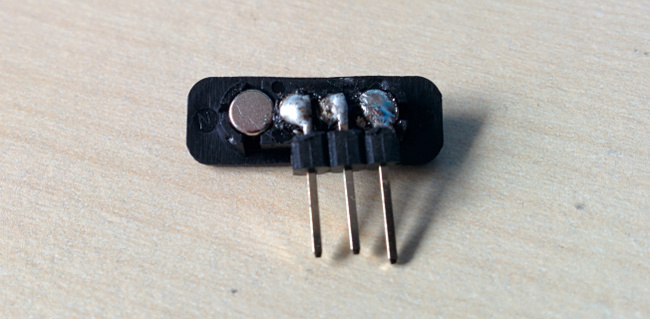

Hack a Charging Cable

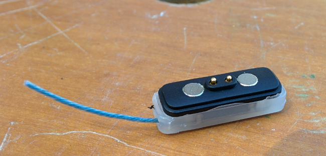

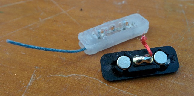

The first suggested method to create a smartstrap connector for prototyping hardware is to adapt a Pebble Time charging cable using common hardware hacking tools, such as a knife, soldering iron and jumper cables. The end result is a component that snaps securely to the back of Pebble Time, and connects securely to common male-to-female prototyping wires, such as those sold with Arduino kits.

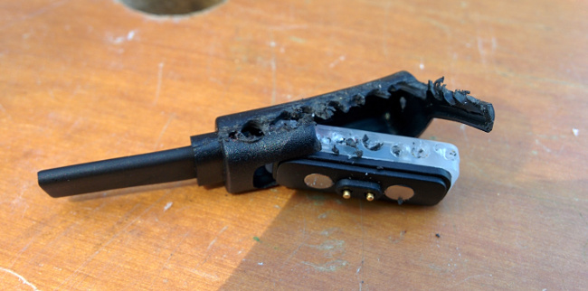

First, cut off the remainder of the cable below the end containing the magnets. Next, use a saw or drill to split the malleable outer casing.
Pull the inner clear plastic part of the cable out of the outer casing, severing the wires.
Use the flat blade of a screwdriver to separate the clear plastic from the front plate containing the magnets and pogo pins.
Using a soldering iron, remove the flex wire attached to the inner pogo pins. Ensure that there is no common electrical connection between any two contacts. In its original state, the two inner pins are connected, and must be separated.

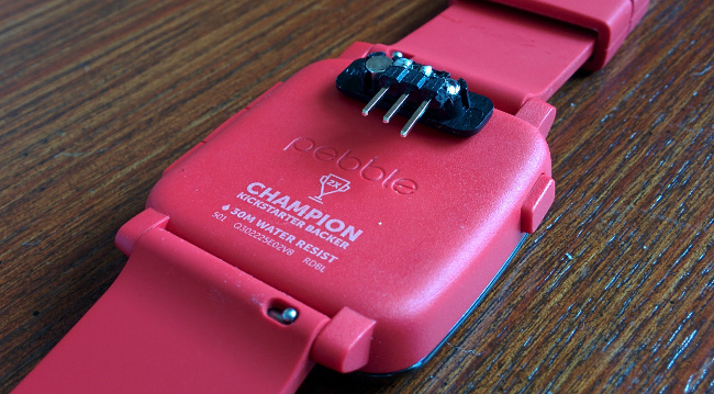

Next, connect a row of three headers to the two middle pins, and one of the magnets.
Note: Each contact may require tinning in order to make a solid electrical connection.

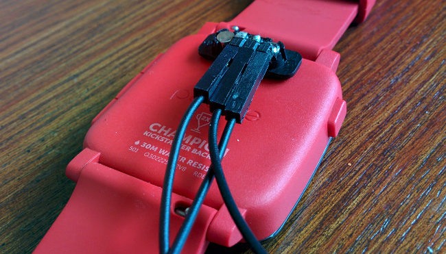

The newly created connector can now be securely attached to the back of Pebble Time.
With the connector in place, the accessory port pins may be easily interfaced with using male-to-female wires.

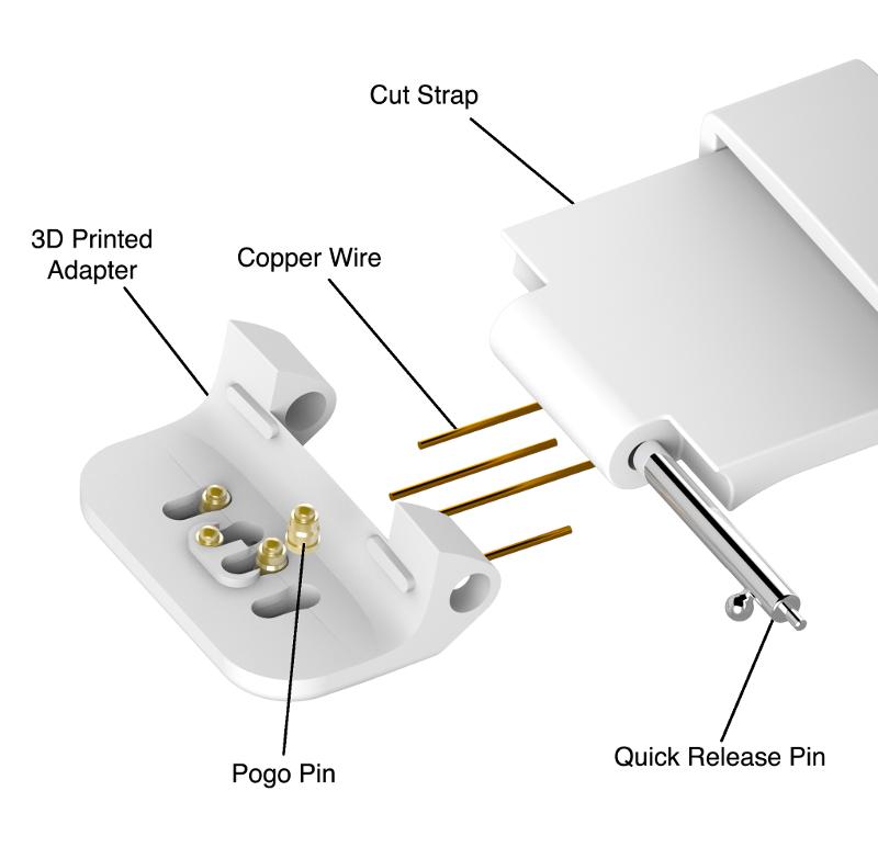

3D Printed Connector
An alternate method of creating a compatible connector is to 3D print a connector component and add the electrical connectivity using some additional components listed below. To make a 3D printed smartstrap connector the following components will be required:
components
  • 1x Silicone strap or similar, trimmed to size (See Construction).
  • 1x Quick-release style pin or similar (Amazon listing).
  • 1x 3D printed adapter (STP file).
  • 4x Spring loaded pogo pins (Mill-Max listing).
  • 4x Lengths of no.24 AWG copper wire.
Construction
For the 3D printed adapter, it is highly recommended that the part is created using a relatively high resolution 3D printer (100-200 microns), such as a Form 1 printer. Alternatively there are plenty of websites that 3D print parts, such as Shapeways. Make sure to use a non-conductive material such as ABS, and print a few copies, just to be safe.
(A lower resolution printer like a Makerbot may not produce the same results. The 3D part depends on many fine details to work properly).

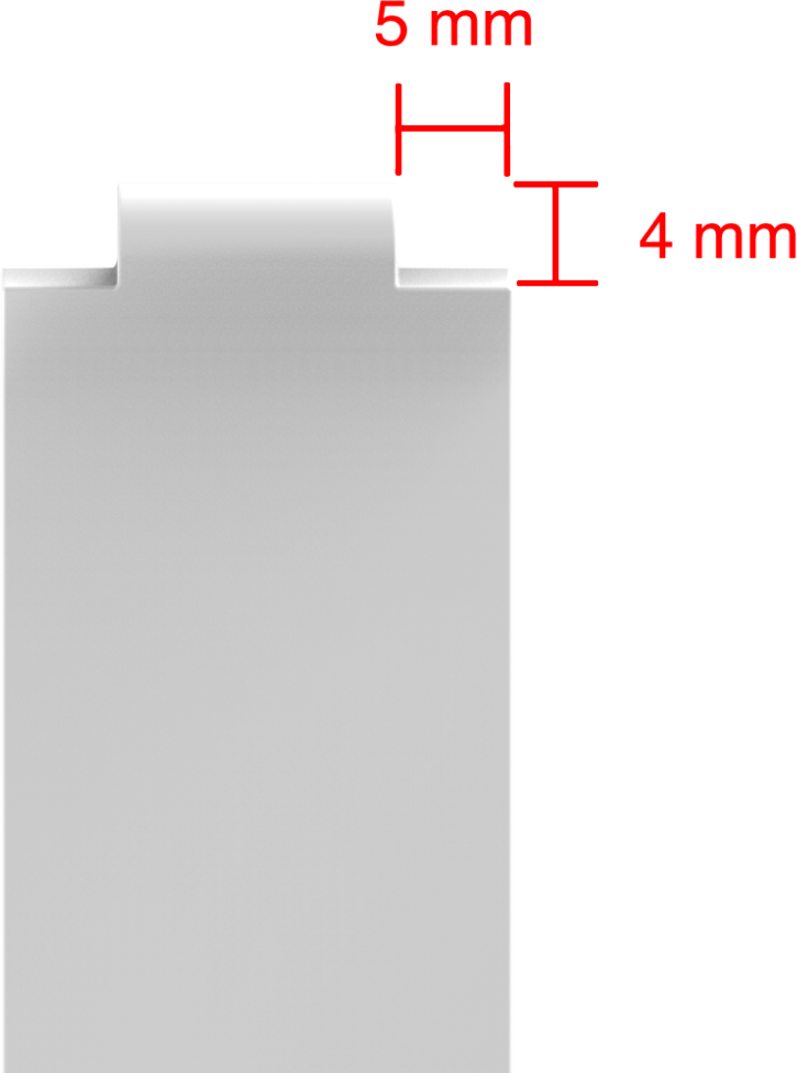

For the strap, it is recommend to use a silicone strap (such as the one included with Pebble Time or a white Pebble Classic), and cut it down. Put the strap along the left and right side of the lug holes, as shown below.
Ensure the strap is cut after receiving the 3D printed part so that it can be used as a reference.
cutaway
Assembly

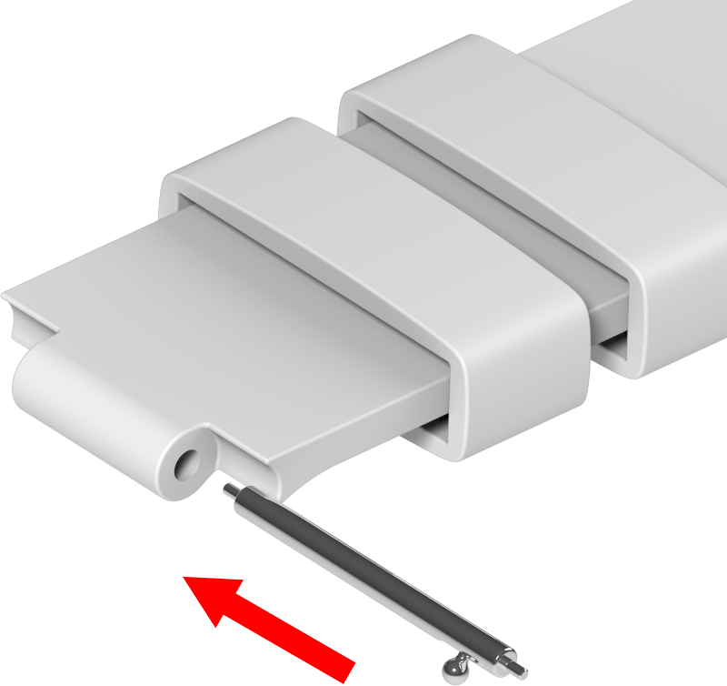

Slide the quick-release pin into the customized silicone strap.
strap-insert-pin
Slide the strap and pin into the 3D printed adapter.
strap-into-adapter
Insert the copper wire pieces into the back of the 3D printed adapter.
strap-insert-wires

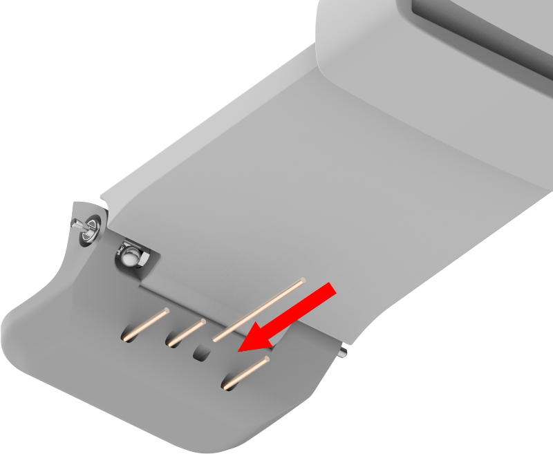

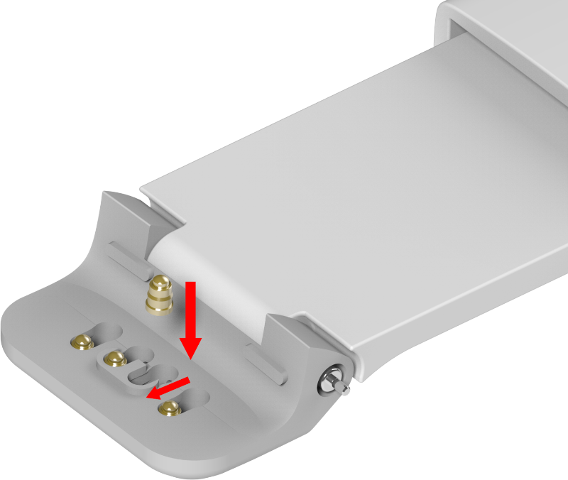

Place the pogo pins into their respective holes, then slide them into place away from the strap.
strap-insert-pogo-pins
