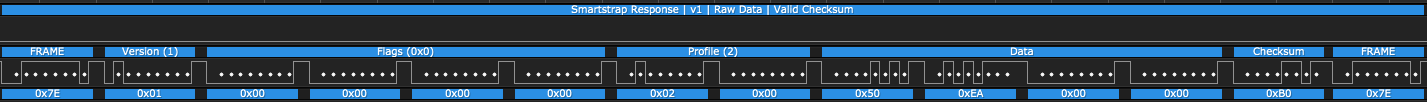

Example Frames
The images below show some example frames of the smartstrap protocol under two example conditions, including the calculated checksum. Click them to see more detail.
Raw Profile Read Request
Raw Profile Response
