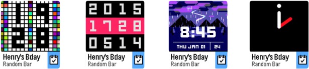

Unobstructed-watchfaces
Sample watchfaces with Timeline Quick View overlay

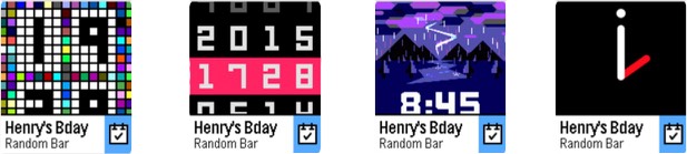

Obstructed-watchfaces
Potential versions of sample watchfaces using the UnobstructedArea API
