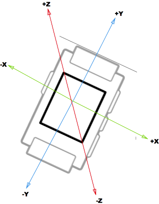

The Pebble accelerometer is oriented according to the diagram below, showing the direction of each of the x, y, and z axes.
accel-axes
In the API, each axis value contained in an AccelData sample is measured in milli-Gs. The accelerometer is calibrated to measure a maximum acceleration of ±4G. Therefore, the range of possible values for each axis is -4000 to +4000.
The AccelData sample object also contains a did_vibrate field, set to true if the vibration motor was active during the sample collection. This could possibly contaminate those samples due to onboard vibration, so they should be discarded. Lastly, the timestamp field allows tracking of obtained accelerometer data over time.
